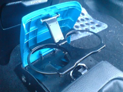

Here are some things ive painted using this technique..
Center Vent..
LED Cup Holder
Clock flap and hazard light..
Gauge Bezel and small vent..
Center Vent..
LED Cup Holder
