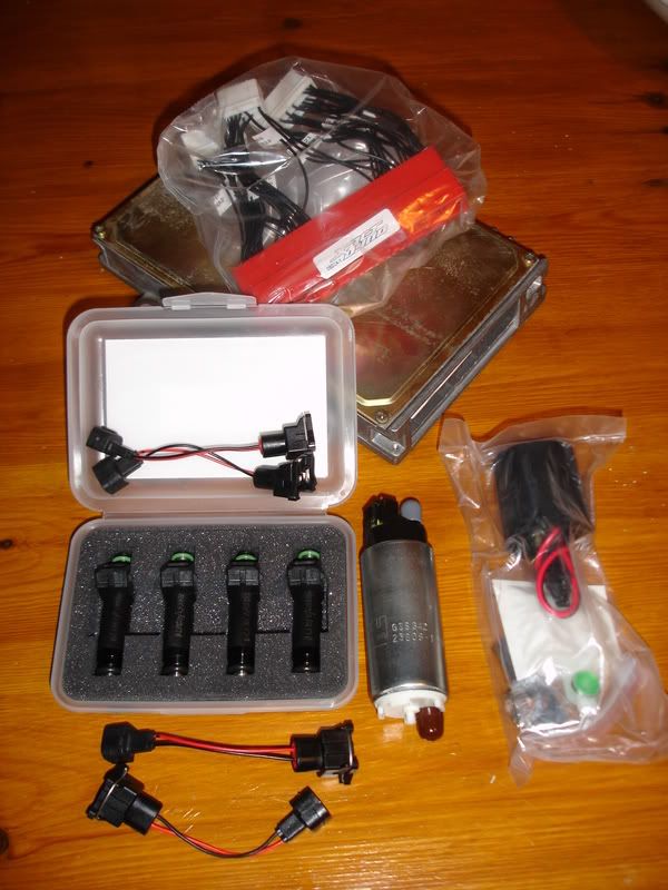

Finally got all my bits from the states, ECU, 650cc Injectors, Walbro, Plug and plays, OBD1 / OBD2a harness etc...
Fitted them today and the difference was startling, its a lot smoother, now revs to 8K+ and pulls a lot harder :D Nearly 70 mph in 2nd ;)
I have removed the FMU and the missing link, the management light now stays off and I'm boosting to 11psi, BUT on tick over it is now hunting :(
When it is warm it is hunting between 1k and 2.5k and the only things I have disturbed is the fuel rail and the injectors on the inlet manifold, (and the map sensor simple "O" ring seal) does anyone have any ideas, come across this prob before when boosting or can point me in another direction :confused:
