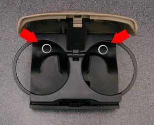

I chose to place the LEDs here:
I think that locating them here, creates a nice enough glow, and as its behind the drinks (when in use) the light doesn't shine in your eye when driving.
Drill the 2 holes, using the same size drill bits as your LEDs (remember you don't have to use 10mm, 5 or even 3 will be fine)
Use a hot glue gun to secure your LEDs, making sure that you only push the led into the hole enough that the tip of the led is flush with the bit of plastic holding it, this way, it wont interfere with the pop up mechanism.

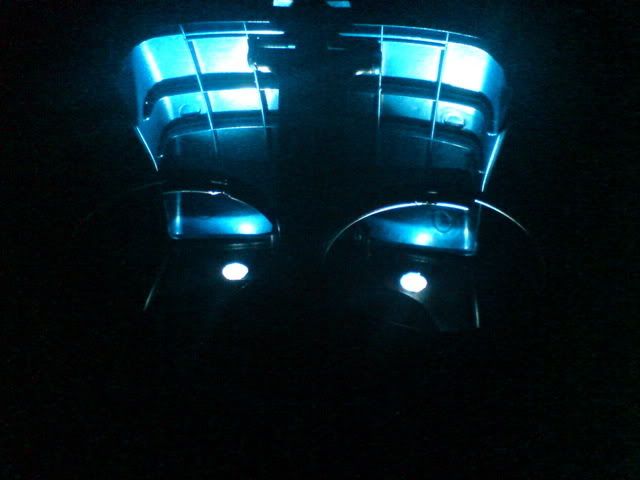

Here is mine..
Any Questions, leave a comment. Ryan
