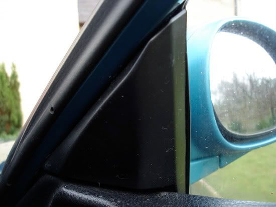

open your door and at the from of the window there is a black plastic triangular cover shown below.
This needs to be taken off. To do this either pop a screw driver or as i did a pair of scissors into the top gap of it and use the door frame as leverage to lever it out.

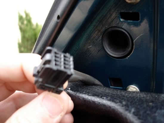

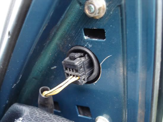

Once you have it off you have to disconnect the small wiring connection (for none electric mirrors, skip this part)
Simply pull this out

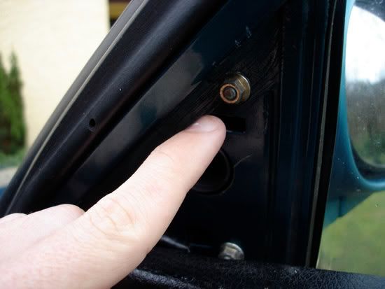

The next step is to unbolt the mirror from the car, this is done by unbolting the three 8mm bolts inside the frame.

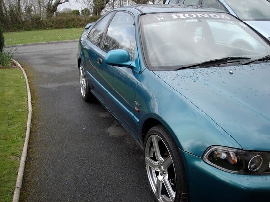

All done, from black to match in no time at all!
