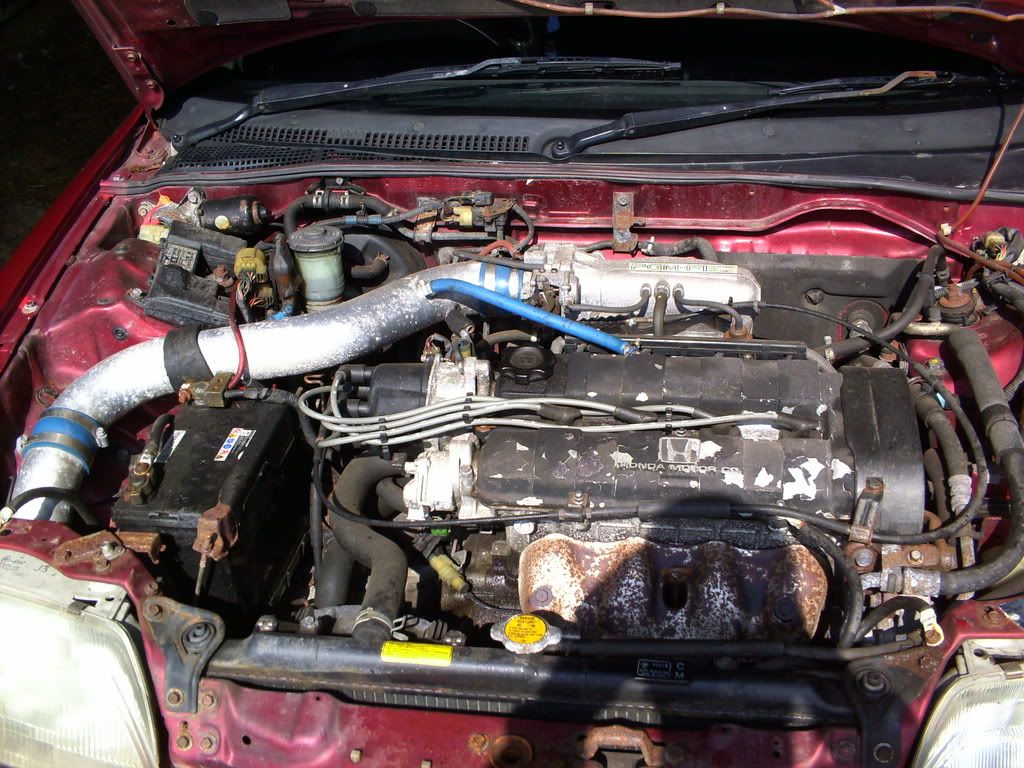

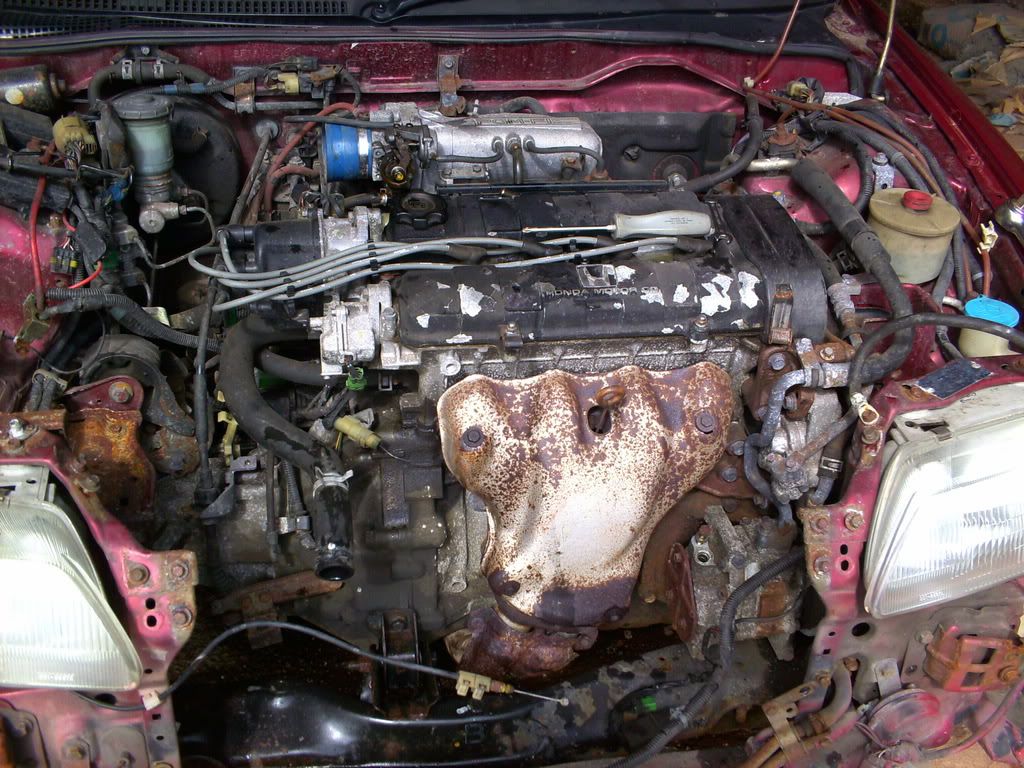

now for the engine as you will probably know the japanese market Si was fitted with a d16a9 DOHC non vtec, or zc in japan, which has 130bhp as standard but thats not why i bought the car
the good old d16 with the cold air intake

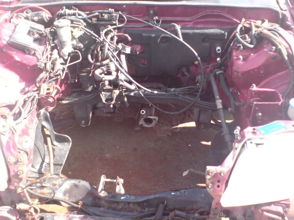

so i took out the engine in febuary i think
and also did away with the air con

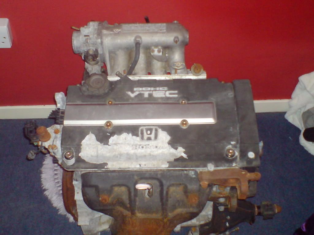

so the two engines
the b16a2 is now completely stripped down and is getting all the gaskets and seals replaced
and the b20b3 i started to strip down this weekend
yes that is in my downstair toilet but i cant be arsed driving to a farm just to work on an engine and i dont have a garage at the house and you cant swing a cat in my shed so the spare bedroom it is :)
